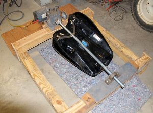

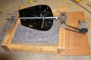

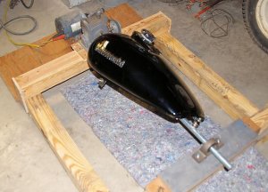

I just wanted to share how I am cleaning the rust from my tank. I built a tank rotator that turns the tank at 23 RPM, I poored a big carton of BB's in it as well as some 3/8 steel balls. It almost sounds like a washing machine when it is running. I elevated one end to make the balls do the lower part of the tank. It is pretty easy to make, I used some short 4x4 and made the main frame, then I took a piece of 3/4 electrical conduit and cut it on one end so it would slide over the shaft on the gear box and clamped it with a u-bolt style clamp. I formed a bracket and welded it to the conduit so I could bolt the tank on with the 2 front holes and just welded a bolt to the couduit for the rear mount. The pictures were taken when the tank was turning. The motor is bolted to a piece of plywood and it simply pushes against the 4x4 frame because of the belt tension. It didn't take that long to build, just a couple of hours, including the time it took to figure it out. I am going to let it turn this direction for a couple of hours and then reverse the motor and let it run that direction for another couple of hours. I really don't expect to see a spec of rust when it is done. Two hours of turning will equal 2760 turns, that should completly pulverize any rust in the tank. Here is a link if you care to see it in action, http://www.youtube.com/v/uBXZtLKMV2Q&hl=en sorry no sound, trying to figure this all out.

As I suspected the rust is gone, the olny place I can see a trace of rust is were the seams were welded together. Other than that it looks it looks like it was sandblasted inside. "Too Kool"

That is pretty cool Imysteryman! What is the gearbox from?
Where are you in Illinois? Make a trip to Indy this weekend and hang with us!
Hi Wuputt
I found the gear box at an industrial salvage yard near hear, if I remember right it was in a metal box and was used as some kind of gate opener. It has a 60:1 gear ratio. Thanks for the invite, I might take you up on that some weekend in the future.
Imysteryman=John I been using this mystery name for quite some time now, I figured we are all somewhat a mystery online thats why I went with it.
