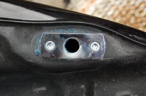

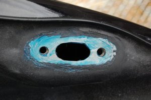

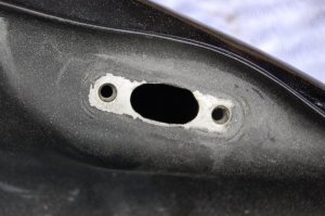

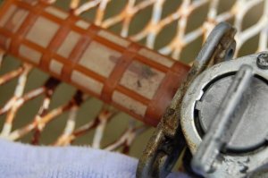

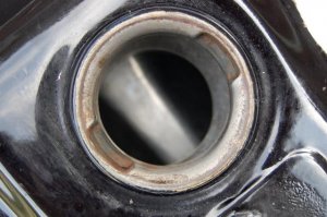

You have to open up the slot for the pingel to fit..If you put the adaptor plate on and look through the hole you can see how much has to come off..Probably 1/16" off each side...but only in the middle section..
Since I had cleaned my tank with evapo-rust, I did not have to worry about sparks..I used a dremel tool which was the slick way...worked great.. Once I was able to slip to the tap in the opening easy, I went back with a file and took off the sharp edges...Then I did a dry fit to make sure it would thread in...good to go...

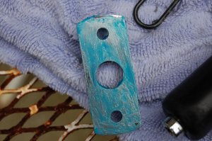

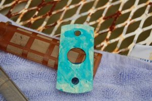

Next, I pulled the screen off the stock tap and blasted the other part with carb clean, then installed it back on the tank...I put about a quart of fresh gas in the tank and swooshed it around to clean the filing dust (the dremel made very fine dust, no chunks...After I swooshed for a few minutes..I put a 5/16 hose on the tap and drained that into my used (nasty) gas can...Then I pulled the old tap off and layed the tank upside down..I cleaned all around the opening with very fine sandpaper and then wiped it with a rag with carb cleaner on it..let it dry...I cleaned the adaptor plate and let it dry...Then with the supplied sealer (blue...messy) I coated all four surfaces, tank, adaptor and both sides of the gasket (all while wiping the stuff off my hands to snap some pics...
You have to let the stuff dry for 10 min. then assemble..
NOTE!!!!!!....THIS WILL SAVE FRUSTRATION AND HEADACHE.....

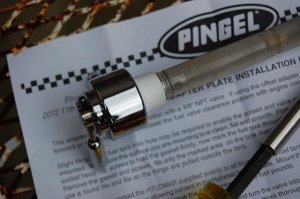

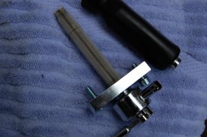

Here is my suggestion....Before you mount the adaptor, mount the tap into it...put teflon tape on the threads and put it in...Wrap a rag around the adaptor and put it in a vise..Check your orientation of where the fuel nipple has to face and then thread tap into adaptor...it may be very hard to line it up exactly where you want it and since it is pipe thread you dont have tons of options for aiming it....I mounted my adaptor on the tank first and after two trys I had to unbolt the adaptor and spin it around...Had I put the tap in the adaptor first, I would have known....
After she was all in and buttoned up...I put another quart of gas in the tank and connected a hose to the tap, then drained gas through it, just to be sure nothing was gonna come out and get into my carbs...
any questions, let me know...here are some pics

I've never seen a "pingle" tap, so does it still have prime, on and reserve? or just on, off and reserve (I can see the reserve label in the photo).
I like it though, it seems pretty simple to use and it looks very neat and tidy. Well done on the neat job installing it.
Mick.
It has on, off, reserve....
There is no vacuum to it like the stock ones...When you park, you have to shut it off or if your carbs stick, it is no good (gas keps flowing)...It is very well made...

Does it say anywhere in the instructions if the reserve/on tube height is adjustable?
Oh BTW Willy. I don't see the inner tube in your old tap. Is it missing? That would explain the no reserve.
When you park, you have to shut it off...It is very well made...

Nothing in the instructions about adjusting the reserve...
I think my tap has been screwed for a while....I had several times where I would run into reserve and then flip to it and the bike would run like crap....That is exactly what happened a couple months ago when it quit on the expressway on me...

Ok, the Pingel showed up today - luckily didn't have to go after it. Pretty cool. I hate chopping into the tank but I think it's a better set up than the stock POS. Thanks to Willy for the tips - if I hadn't done the dry fit with the adapter and valve, I would've had a mess and been ****ed off as it took several tries to get the outlet and everything lined up and facing the way I wanted. I bought the Hex valve - read through the instructions as there's a good tip on not scratching the chrome by taping up your wrench before installation - never would've thought of that on my own - hahaha. All I can say is man that thing will flow some fuel. During the flush/drain, with the Pingel on, it really pours out!!!!! Keeping the carbs in check will be a must now - definitely time to find a good inline filter - although it looks like it would take a freakin' ball bearing to clog up that valve - just don't want anything getting down to the needles though.
