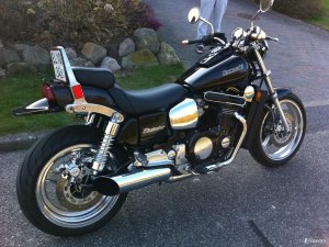

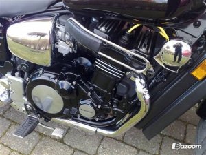

So Martin, attached the ZRX(!) carbs pic; as you can see they sit very close to the ZL9 airbox, no simply plug'n'play. To change the main jets w/ the orig. ZL9-ones is only a suggestion, AFAIK the ZRX has main jet size 95 so maybe something between 95...125 will work (110?). When you got your bike running well, please share your experiences - that's what this forum is for. Good luck! :thumbsup:
attachment.php
attachment.php
Wow that is one beautiful bike, will definately update the progress when and if i can locate the carbs , thanks so much for the ideas and watch this space ;-)
I don't know what he finally got for the beauty, still remember an advertisement of DKK 65.000 (~ $US 9.812); point is: you will NEVER EVER get back what you once invested in blood, sweat, tears & money. HDs you can get on every corner, this ZL is unique...I cannot share his decision.
