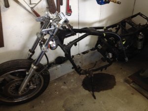

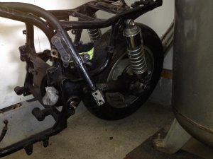

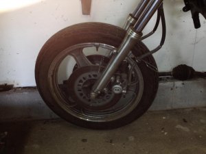

I got them they on a 1000 but are the same!!! Pm me if your interested!!!

markus56,
The Front tire on that ZL600 rim is the same size as the one on my ZL900. Everything else looks the same as well. The rear on the ZL600 has a 150/80-15 on it, that's why I'm not sure about it's width. I called the Dealership and they told me they show different part numbers for each, but that does not mean anything. I had several ZX-12R bikes in the past (years 2000-2005), and many of their parts numbers were different from one year to another, however, more than 90% of the parts were a perfect fit!

The 900 rear is a disc brake. The 600 rear is a drum brake. The 900 front is a dual disc and the 600 front is a single disc.
Well, I guess that settles it. I guess the only ones that are a good fit and are swappable, would be the ZL1000 rims. Thanks.
