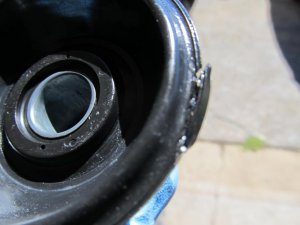

Hey guys, I sent off my carbs to be ultasonically cleaned and just repaired in general. The guy calls me today and asks me about the jet kit that has been put on it. He says the main jets are #136, but the pilot jets are a stock #35. He says part of my starting problem may not just be because my jets are clogged, but could be because the pilot jets should have been bigger like my mains were. The previous owner put this kit on so I don't know what's supposed to be on there. I tried searching this site and even researching most of the jet kits in general but no mention of pilot jet size, besides stock. SO. Should I have him just put those back in? Or is there a bigger size that needs to be used? Since I bought it from the PO I've changed the pods from THESE to THESE. Would that affect anything as well?
Also, seems someone pinched off a small piece of the diaphragm when they put it back together. Would anyone know where I can get one for a decent price if he ends up not able to fix it?
See my post in your other thread concerning your jets. As to the part you need, don't limit your search to parts for the 600 as the Kawasaki Voyager X11 (1200) uses the same part.
