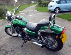

Hello, I'm hoping someone here can help with a problem I'm having with my 1996 Zl600-B1
