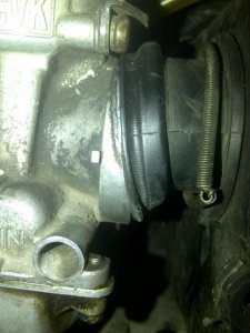

Found out what's wrong! :D :thumbsup:
The rubber bits going from the airbox to the carbs are not attached properly and are old and inflexible.
Went to see the nice Kawasaki mannie in the big green Kawasaki shop and they don't make 2 out of 4 of them. :(
He's saying get rid of the airbox and fit K&N filters, but that'll mean re-jetting. I don't really understand what he's on about, apart from it's going to cost me a bloody fortune! :(
Anyone got any suggestions?

:hello: Are they the air ducks between the motor & carbs or the ones from the carbs to the air cleaner. If the later the K & N pods will work. Most of the time you can go up one size on the main jets & one size on the pilot jets. It also depends on elevation. Also may have to raise the needles one notch. R. J.
:hello: If there are no holes in them or not cracked you can soften them up with a penetrating oil like WD 40 or a rubber enhancer like Armor All. Also I found that brake parts cleaner/carb cleaner will expand the rubber to get the boots to go back on. They shrink over time from age & heat off the motor. If they came with springs that hold the boots to the air box & you can not get new ones you can use safety wire to secure them to the air box. Also if there is enough room you can use thin/narrow hose clamps. I would order the 2 that are still available & try to find the other 2 used that are better than what you have. R. J.
I would think the ZL600 boots are still available and I would bet they are the same part. I know these can be ordered in the US. I got a set about a month ago. I tried to use old ones and about killed myself. The new one popped on in about 10 minutes and fit very well.

I've already got the part numbers that I'm looking for as I've got the manuals from the downloads section of the forum. Nothing found in the UK and Europe and I doubt I'll find anything in USA as, from what I can tell, they weren't meant to be exported from Japan. :( Need to learn Japanese and go hunting. ;)
I'm not keen on using 2nd hand parts either, as they're going to be from 1991 at the latest.
I'm going to see how I get on with pods and re-jetting. I've got the tools, I just need the confidence! It's coming up to riding season too, so I don't want much more down time! :(
Thanks for your support, Gentlemen! :) :thumbsup:
