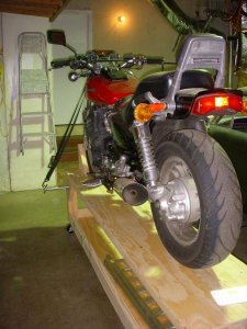

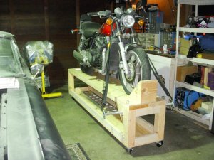

I'm new to this forum and have a two Kawasaki Eliminators. A Black 1987 ZL1000 and a Red 1985 ZL900. I recently over heated my ZL1000 when my water pump went out. After replacing the water pump on the test ride I noticed Oil misting and foaming out of my crank case breather and it was milky. (Bad News) When I got it home I checked the oil and its awash with water. A foamy mess. I was sure It was a blown head gasket and wanted to get into the engine anyway so last night I pulled the engine apart only to find an apparently good head gasket. I'm wondering what other ways water can make its way into the oil on this bike. Any help is much appreciated. I will post pics when I can.
