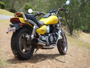

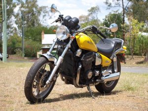

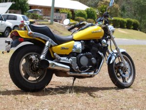

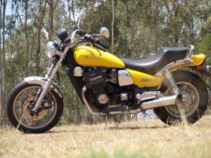

09 OCT 11 There was a ZL1000 for sale on the side of the road. I checked it out and the next day checked it out again and purchased it. It was originally Blue but the previous owner painted it Yellow. It Starts first kick every time, runs perfectly, although a bit hot if i get stuck in traffic. Has some dents from being dropped a few times. Badges scratched. Radiator shroud is broken.
Im wanting to restore this bike so im creating this thread to post updates and ask advice from anyone who can help me. P1011310.jpgP1011306.jpgP1011313.jpgP1011312.jpg

Welcome to the site, see you've got the euro model with the short sissy bar. Also looks like someone has replaced the instrument cluster with ???, not sure where that came from.
First thing to do is remove the horns and make sure the chrome covers are attached to the actual metal horn by some form of adhesive, the covers come off easily without extra grip from something and are difficult to find [and expensive when you do find them!]. A lot of the other parts [original style turn signals, etc] can be sourced from eBay, just watch the prices and compare to new when it's still available. For example, there are constantly sellers listing the chrome swing arm caps for $20-30 USD, where a new factory one [which is still available] is $8.40 USD. Turn signals can be a little tricky, a lot of the ones advertised are either very generic or two wire only, in the US we need three wire for the front since they also act as running lights. Not sure about your specific bike...
The right mufflers come up on eBay occasionally [no longer available from the factory], the ones from a ZL900 look similar but aren't an exact match if your doing a factory restore. Also, the speedo on a 900 will fit and function, but it has a slightly different face. Radiator shrouds are scarce, they break easy and neither factory or aftermarket available; those are the same between a 900 and a 1000.
Somewhere on the site there is a thread showing the differences between the US and Euro model of the bikes, you might find that interesting. Use the site search option to locate it.
Good luck with your project!!

I want to get the cluster changed ASAP. There are holes in the back so bugs and water keep getting in. The bike the cluster came from must have had atleast a windshield.
It makes sence this looks like a hybrid. The guy I got it off had a hard time sourcing parts so he got them from all over, different bikes, uk, us, Japan, or just made them himself in the case of the windshield it had. But the PVC was smashed when my father laid the bike down while moving it in the carport. Also snapped the footpeg off. :(. If someone knows the best place to get the new cluster from would be awesome. First things I'm doing is fixing the buckled brakes, cluster, cooling issues.
And yes, the gauge cluster off a GPZ1000. Thanks for all your advice and suport so far.
