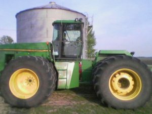

I saw tons of bikes out this past weekend.I would have liked to be,but this is all I rode.About 15hrs fri,sat,and sunday.Gotta pay for the toys,and its easy extra cash.
