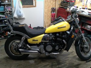

didn't get to work on my bike this weekend. I did however order some new airbox boots & springs. heres a picture of my beast before i paint it this winter.0923131916.jpg
