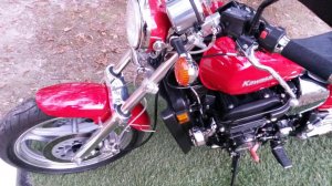

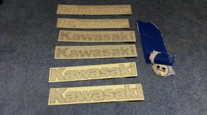

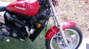

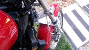

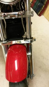

May give Dana a call & send pics of all parts to be painted but I'm pretty sure it's going to be pretty pricey with shipping. Had this fender painted last week at a local shop last week. The scanner came up with a Fiat color so I gave it a try and it's pretty close but not spot on. 3 step and pics really don't do it justice. Looks nice but has a very slight metal flake to it. Ill keep him in mind depending on his total price for the rest of the bike. It is close though when looking at it in person.f-150 parts& new paint on zl900 fender 048.jpgf-150 parts& new paint on zl900 fender 056.jpgf-150 parts& new paint on zl900 fender 055.jpgf-150 parts& new paint on zl900 fender 057.jpgf-150 parts& new paint on zl900 fender 049.jpgf-150 parts& new paint on zl900 fender 053.jpg Have these also thanks to Markus56.
