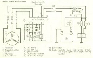

A page out of the ZL600 supplement:
I have no idea how close this is to a ZL400 but, I had to replace my Voltage regulator because mine had a terminal broken off of it. This type of Voltage Regulator is on lots of Kawasaki equipment, Don't go buy a 20 something year old used regulator off of ebay ..... You can sometimes find this type of regulator on lawn equipment. I don't know if this page will help you or not: http://www.psep.biz/store/kawasaki_motorcycle_voltage_regulators.htm
From what I know, the stator on this type of engine rarely goes bad. Mine had the yellow wires melted together and after separating the 3 wires and taping them and replacing the connection to the regulator my 600 charges like mad.

The pin-out is shown in johnny's post above.
