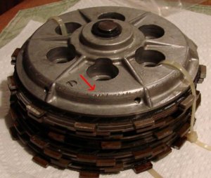

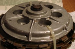

rattling - Streched Chain?
I found these marks on the clutch plate. I think my problem is a streched chain.
Does any one agree?
Could these mistry marks appear when with chain is flying and pushing the tensioner out where it touches the clutch plate?

Re: rattling - Streched Chain?
Does any one agree?
That is coming from the tensioner itself. look at the metal part of the tensioner and you will see the correspnding marks. If the rod is broken or slightly disfigured then it won't lock like it supposed to, it is a one-way tensioner. Rough idle is what causes it to slap the clutch.
