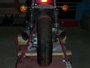

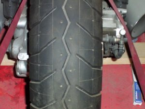

Technically the Shinko is wider and taller, but the width might look similar when shinko is mounted. There have to be some pics of the shinko mounted up on this site.
The shinko rear
Still totally unclear to me as to what the WIDEST rear tire might be that would mount-up and fit within the dimensions of a stock ZL swingarm...?? :?: :confused2:
SO CAL ZL
I have Metzeler ME880 200/70-15. Bought it for Usd 225 from Ridersdirect on ebay. Needs to be installed without air and then pumped up after installation. I cant imagine fitting any wider than that....
Metzeler's allowable rim width for this tire is 5.5 to 6.5". The ZL rim is 4". If you have a stock rim, the tire is probably really pinched in, and not at it's true width.
I believe someone said with the Mean Streak wheel fitted, a 180 or 190 was max without rubbing the swingarm. But yeah, depends on tire brand too.
