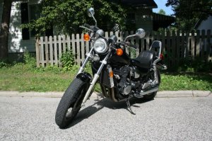

Let me first say upon my virgin post that I very much love owning and riding my 1986 ZL 600 eliminator, and I am really happy to see such a great online presence for other people who own them and are enthusiasts! :winkcool:
Unfortunately I come to this forum with a problem with which I need the opinions and advice of other people who own this same motorcycle.
My baby is running well for most of the time. However, after about a 20 mile ride out into the country, as well as getting about five stoplights back into town, the RPMs accelerating from a stop will become extremely erratic, with the needle jumping from 1.5 thousand to 4 or 5 thousand RPMs until the engine just quits altogether. Occasionally there has been a rare, but very loud backfire just before the engine quits. The odd thing is that I can start it back up it will idle just fine. I can can even ride it very gently and slowly in first and second gear as long as I keep the RPMs down around 3 thousand. When I get home and let the bike sit for a while it will start up and the problem seems to be gone.
Now, some history. This happened to me about a week ago after the I enacted the exact same circumstances. I took taken a 20 mile ride into the country and about 5 stop lights back into town the above symptoms occurred. It also happened again last summer. Every time this has happened it has been after a long ride. Always in town, always after about 20 miles.
Now, my hypothesis... My first thought was that it could be a vacuum leak. After the first episode I found a spring clamp on a rubber boot connecting #1 carb to #1 cylinder. However I tightened it and the problem occurred again. The circumstances tend to suggest that regardless of what is actually occurring inside the engine, lots of heat seems to be triggering the problem. Even the fact that this has happened only in town once I've slowed down seems to suggest that the lack of airflow through the radiator and therefore more heat buildup could be contributing. Perhaps it is a vacuum leak that is happening when something gets hot enough to expand a rubber piece to the limit of creating a leak.
I am currently doing a complete flush of my coolant system. My reservoir tank for coolant was empty when I opened it up, but there was coolant all the way up to the to the radiator cap when I took it off.
The radiator fan seems to be working fine whether the engine switch is on or off, or whether the bike is running or not. I am now starting to suspect that if something is wrong with the coolant system it could very well be the water pump. Perhaps the gear that runs the pump is stripped. Although I have no idea how to test this as the water pump should only turn on when it is activated by the thermostat.
Any ideas on what could by causing this problem given the above circumstances. Any methods of isolating the vacuum leak? If you agree with me that the problem is caused by too much heat, could the water pump be the problem? If so, how do I test the pump to see if it is working. The manual(s) say nothing about the water pump. :help:
