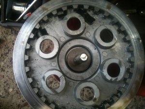

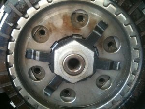

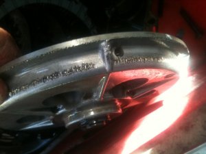

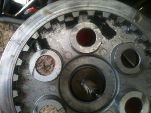

Here is the update. I disassembled and cleaned the master cylinder out inside and out. Put it back together but the bike still creeps when clutch was pulled in. I then took the clutch cover off and here is what I found on the spring plate pusher (see image). It was dinged up a bit and scraped as if it had been hitting against something (but what?). Maybe the previous tensioner had broken but it has been replaces as the tensioner looks good. So I pulled the plate off and I could see that the spring leaf was busted in two places (see pictures).
Now just a couple of questions:
  1. Would a broken spring leaf cause the bike to creep when clutch is pulled?
  2. I can not pull of the basket because i do not have the special tool that holds the basket in place when you undo the nut. I could go and order this tool but has anyone got a special home made idea that works for preventing the clutch from turning while you undo the nut?
Many thanks
Many thanks
JohnView attachment 13335View attachment 13336View attachment 13337View attachment 13338
yes.... An impact gun
The impact gun will spin it right off and out run the basket. I believe you are going to find the bearing seized to the shaft and that's going to be bear.
As long as you are going to need a new leaf spring, you might as well do the concourse upgrade - link below. And as far as getting the clutch nut off, an impact as mentioned above helps, and it's not really advised, but in a pinch, if you are very careful, you can put some of the bolts back in the clutch and use some sort of pry bar between them to hold the clutch still - again, this is not really advised , since you can bust up your knuckles pretty good if it slips apart and possibly do more damage to the clutch/bike/etc. The special tool - clutch holder can be bought pretty reasonable from Motion Pro. Good luck. Later.
