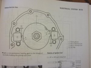

And your random cylinder dropping, I would ohm out the pick up coils and also check the gap between them and the advancer. When was last time you cleand the spark plug caps, they have a small resistor in them also. NGK makes a replacement cap (sorry don't remember part##)

the forks are straight they've been checked, ive got a feeling its tyre wear and probably the bearings. today ive changed the coils and trimmed ht leads to make fresh connections. ran out of light so didn't have time to clean caps.. not sure what ment by check distance between coil and advancer ? how do you do that and what am I looking for lol.

The pick up coils are on the left side (kick stand side) under the round cover on engine,this engine is up side down but you can see the pic up coils on each side of the advancer!
attachment.php
:hello: This is from the GPZ 900/1000 1984-87. Base manual electrical system Chapter 16 section 16-18, 19 & 22.
