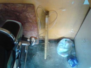

Hello fellow riders! I today synced my zl-s carbs with self made tool(added picture ot it too) and changed spark plugs (old ones were rusty and 3 diffrent types). I iddle is now smoother and i dont hear anymore chain noise. But there is one little issue maybe i just want too much, but idle rpm-s are wery little up and down 50 +/-, uploaded video of it to youtube:

That's a home made manometer, for showing pressure delta. You will have to have some way to buffer the vacuum pulse and keep fom sucking the fluid out. Very primative but works. IMO, just buy a real sync gauge.
first i synced 1 and 2 with that tube (filled with motoroil, conected to carb vaccum holes between im syncing) then 3 and 4. after i used screw between 2 and 3 to sync first and second half. Did i do it wrongly.... or something bad doing like that? it was my first time doing it.......

how do you sync carbs with a 2x4?
I figured you used it like this...:Whaxatk:
Naw I'm just bustin your chops...Whatever works for ya bro!
i did plugs from wood and put them into the vaccum hoses. Whitout them cycle didnt work at all, and measuring was impossible. "Sucking" the fluid out wasnt problem, tubes were enough long, and balance changed swiftly. But who ever else is going to this way put oil into the tube at least 30cm (oweral leght), less wont do the job. real gauge costs like.... i wanna pass that :notworthy: mine did 3 euros only:hello2:

The idle going up and down is normally a sign of "hunting", some of the causes are vacuum leak, idle mixture screws, bad fuel. Doesn't sound like you removed the carbs, but might be a good time to remove and clean. But check the easy stuff first.
