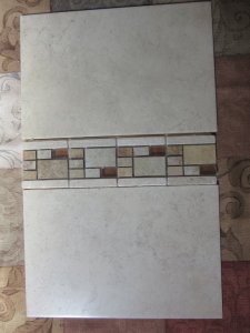

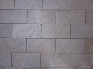

    :hello: I put the brakes on all my bike projects. To hot outside to be in the garage. My Son Jared and I gutted our hall bathroom Sunday. Time spent 10 hours. We filled up 5 garbage cans with construction debris. We are using 12"x 8" tile in the shower enclosure along with a matching decorative trim. We are using the same tile on the floor that we used in our Kitchen. __________________________________________________ IMG_7961.JPG IMG_7962.JPG IMG_7963.JPG IMG_7964.JPG IMG_7967.JPG IMG_7965.JPG IMG_7966.JPG

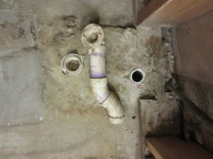

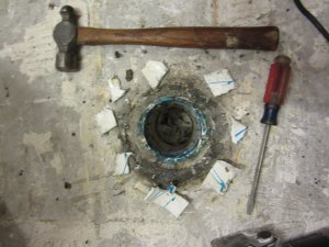

    :hello: Today I busted through the bathrooms concrete floor to get to the tubs 2 drains. It sucked. I broke off the tubs over flow drain when we was prying out the old tub. It snapped off level with the floor. :pain10:. Also the toilets floor area sits higher than the rest of the floor so I cut the toilets floor mounting plate off with my Rockwell muti-tool. Greatest power tool that I own. Time spent 3 hours. Next I'm going to level the bathroom floor. First I'm going to grind down all the high spots the best I can then poor floor leveler. __________________________________________________ IMG_7971.JPG IMG_7973.JPG IMG_7969.JPG IMG_7970.JPG IMG_7972.JPG

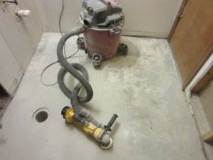

    :hello: This morning I ground off all the old thin set off of the bathroom floor. Then I ground down all the high spots. Time spent 4 hours. I zip tied my shop vac hose to my 18 volt grinder to suck in grinding dust. I went through 8 batteries in 4 hours. ____________________________ IMG_7974.JPG IMG_7975.JPG IMG_7977.JPG IMG_7978.JPG IMG_7979.JPG IMG_7976.JPG

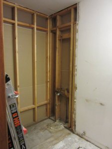

    :hello: Thanks. To hot to ride here but I might go for an hour or so first thing in the Morning. While I won't have to do anymore grinding. I checked the floor with my 6 foot fat max stanley level. It's good. Next I'm going to do some drywall mudding. The tub/shower area had a 16 inch drop bulk head. My wife wanted it gone. Without it the bathroom looks larger. Also it will let more light in the shower. We hung new 1/2 inch drywall over the bath tub area. IMG_7980.JPG IMG_7981.JPG

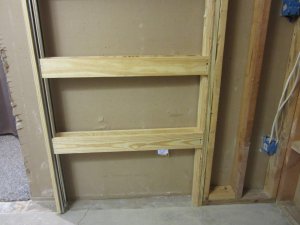

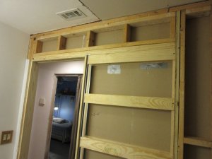

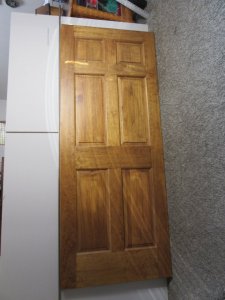

    :hello: Monday I stained and urethaned 2 of 6 32 inch wide 6 panel solid wood doors. I'll be doing all 32 inch doors for all the rooms. I also installed the pocket door frame in the hall bathroom. _______________________________________________________________________ IMG_7985.JPG IMG_7982.JPG IMG_7983.JPG IMG_7984.JPG

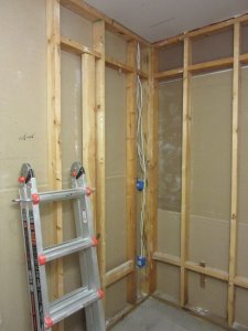

    :hello: I Spent most of the day at Lowes and Home Depot getting materials and supplies. I picked up our new bathtub from Home Depot. Cost was $250. I did manage to put the header above the pocket door frame. I also cut in the hall side of the drywall around the pocket door frame and screwed the drywall to it. I had to relocate the halls outlet to the corner just below the light switch because the door would of hit it when sliding it into the wall. Also I had to plug the old outlets hole. ______________________________________________________________________ IMG_7986.JPG IMG_7987.JPG IMG_7988.JPG IMG_7989.JPG

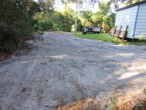

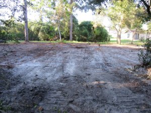

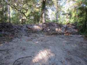

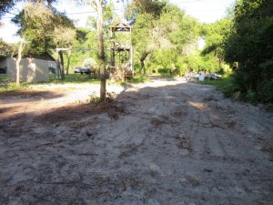

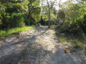

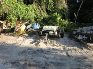

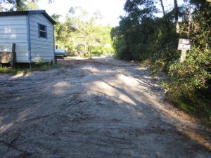

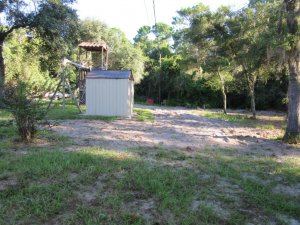

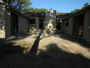

    :hello: This past Sunday my good Friend Nick H. brought over his Bob Cat to do some clearing and leveling for me on my 3 lots. He only wanted $80 to do the work which took him about 3 hours so I filled up his Cat and Truck. They both took about $100 to top off the tanks. I'm going to pour a concrete slab between my 2 addations that I added on in 1997 and 1998. I also had Nick block off the dirt road running through my neighbors 5 acres. He and I was tired of all the traffic going in and out. He did not use the dirt road. It started out as a dirt bike trail and the trucks started using it. I got tired of all the trucks going in and out (sometimes 30 a night) all hours of the night and he was tired of all the people trashing it up. IMG_7999.JPG IMG_8000.JPG IMG_8001.JPG IMG_8002.JPG IMG_8003.JPG IMG_8004.JPG IMG_8005.JPG IMG_8006.JPG IMG_8007.JPG

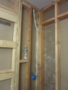

    :hello: Today I tacked up the wiring for the switch and outlet that is on the hall wall. I also hung 3 sheets of 1/2 inch dura rock concrete board and 3 small sheets of 1/2 inch drywall around the inside of the pocket door frame. Time spent 4 hours. The next thing I'm going to do is do some drywall mudding. IMG_8008.JPG IMG_8009.JPG IMG_8010.JPG IMG_8011.JPG IMG_8012.JPG IMG_8013.JPG IMG_8014.JPG

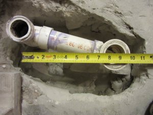

    The tub drain measurements do vary from tub to tub although the standard measurements are 14 1/2" from the wall and 2 1/2 out.

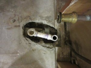

    :hello: Thanks. What about the overfow drain for bath tubs. Are they all the same height. I have not taken the new bath tub out of the box as of yet. It's made by AQUATIC. Is this a good quality tub. I like how it is designed. I don't like medal tubs and cast iron ones are to heavy. IMG_8015.JPG IMG_8016.JPG

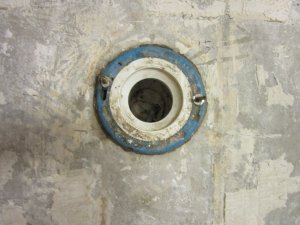

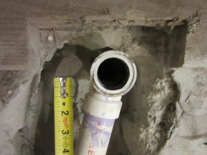

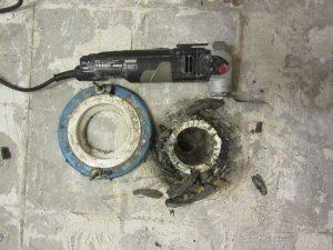

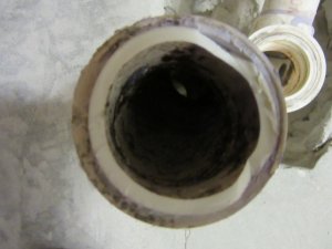

    :hello: MARKUS: My bath tubs drain is 8 1/2 inchs from where the edge of the drywall would be or 9 inches from the studs to the center of the drains pipe going under the slab. I'm going to try to use the old overflow drain that broke off if I can. If not will I have to remove more of the slab and replumb from the ground up. I'm hoping that I don't have to do anything with the 8 inch main drain because I'll have to dig deeper to get to it. I'm going to use my ROCKWELL multi-tool to remove the broken off pipe from both the pipe in the floor and the pipe going to the overflow drain. IMG_8017.JPG IMG_8018.JPG IMG_8020.JPG IMG_8019.JPG
  19. R. J.
    8,983
    482
    :hello: MARKUS: I got the broken off pipe out of the floors overflow T pipe without damaging it but I cracked the 22 1/2 coupling. I'm just going to buy all new overflow drain hardware. ____________________________________________________________________________________ IMG_8021.JPG
  20. markus56
    3,383
    191
    Yeah, I'd build a new drain for it and since you have the tub already, I'd take it out of the box, level it up and take good measurement directly from it.
