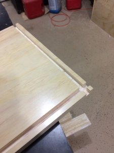

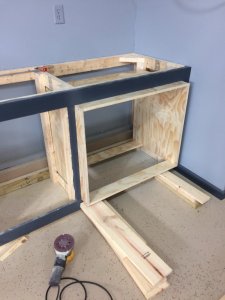

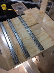

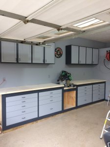

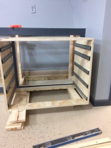

    More pics
  2. R. J.
    9,677
    625
    :hello: Great job Bill. :notworthy:. Did you use a table saw to do the miter cuts.
  3. WillyD
    WillyD Senior Member
    3,313
    91

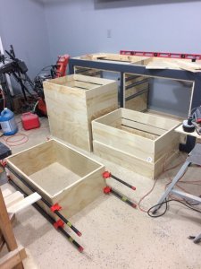

    Yep. All done with a stacked dado blade on my table saw.
  4. markus56
    3,459
    218
    Nice job Bill, turned out great. There's no substitute for organization and knowing where everything is.
  5. WillyD
    3,313
    91
    Yes. I’m getting excited. The drawers were a huge set back but now I’m back on track.

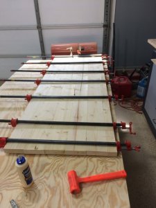

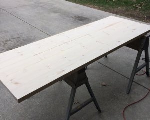

    D0718E86-B9A2-4889-BF8C-C3E648021631.jpeg 12D1CECE-3906-42D9-A67F-521ACC111296.jpeg DF5E4C6C-4AD4-4ED6-8D68-E40C068B8E8A.jpeg Well yesterday I glued up my bench top panels. I used 2x6 material. I used my biscuit jointer and glue and clamps. Today I did initial sanding. Ends will be cut to size and squared up and the ends and front edges will get maple on them to dress them up.

    :hello: Nice. :notworthy:.

    I'm gonna' have to take a ride North this year and check it out! Great job Bill.

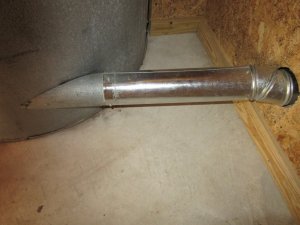

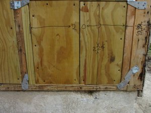

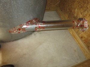

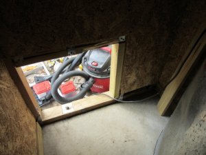

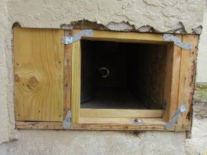

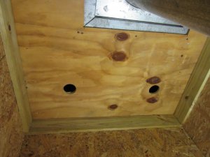

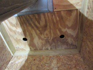

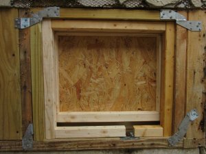

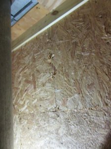

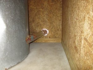

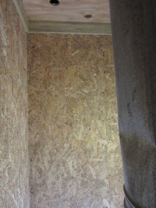

    :hello: My fireplace was not drawing correctly. It's called a zero clearance fireplace. This past Sat. I replaced my fireplace draw vent pipe. The pipe was a plastic flex 4" dryer vent. :dontknow:. :banghead:. It melted. :nono: Also I installed 3/8" OSB on the inside of the fireplace walls. I drilled four 3" holes in the ceiling to let heat out. The chimney O.D. is 14 ft. tall, 4 ft. deep & 7 ft. wide. It has a divider at 8' so that the double flue pipe does not flex. IMG_5239.JPG IMG_5244.JPG IMG_5250.JPG IMG_5241.JPG IMG_5242.JPG IMG_5245.JPG IMG_5246.JPG IMG_5247.JPG IMG_5251.JPG IMG_5254.JPG IMG_5257.JPG

    Very nice job. Looks great.
  17. R. J.
    9,677
    625
    :hello: Thank's. I still need to do the stucco.

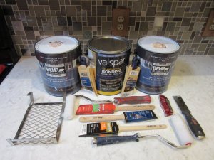

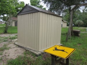

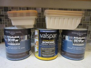

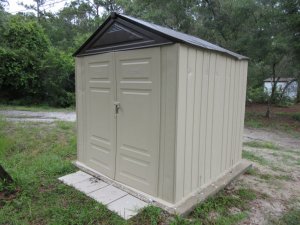

    :hello: This past Sat & Sun I painted my plastic shed the same colors as my house. I used Valspar bonding stain blocking latex primer 2 coats. $30/gal. I used Bear premium plus ultra enamel paint. $45/gal. The roof & endgables took 3 coats of brown & the walls took 2 coats of almond. IMG_6161.JPG IMG_6162.JPG IMG_6163.JPG IMG_6164.JPG Total cost with rollers, brushes & trays around $175.

    Wow. That turned out really nice RJ
  20. R. J.
    9,677
    625
    :hello: Thank's Bill. I'm going to do my Medal shed the same way.
