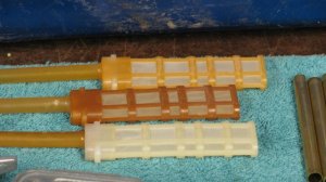

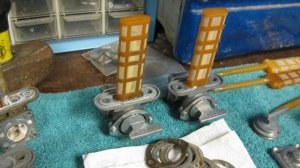

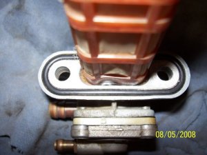

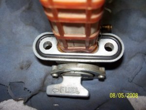

    For those of you wondering about the figure8 disease the filter gets after time here's a few pics attached. As you can see the gap between the filter and housing will let the dirt right on by unfiltered. This ends up in your fuel bowls or stuck in your float valves causing the carbs to leak which can also hydrolock the cylinders bending a connecting rod. Common problem with bikes that have this filter design.

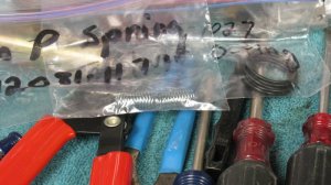

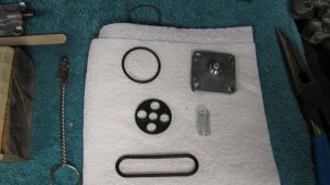

    I decided to include the tap spring in the parts lot that I will replace with OEM parts in this service so the list reads as follows;
    1 - lever o-ring ( Service is $45.00 with a good core and $75.00 without a core )
    1 - valve gasket
    1 - oval o-ring
    1 - diaphram
    1 - spring
    For the members that will be doing this rebuild yourself, do yourself a favor and use ONLY OEM parts! Look these 5 parts up and you'll see that the OEM parts are double what a K&L kit is.......there's a reason for that guys! Don't try to skimp here.....it may cost you a motor rebuild! Get the OEM parts like I do and sleep easy at night. For those that want to put off this petcock rebuild till spring, at least take a tip from Lowlife and disconnect your gas line from the petcock till you do rebuild it! Get these things done people.....it's a very serious thing!

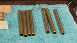

    After cleaning and rebuilding several of these petcocks already, I want to share some observations I've encountered along the way. The biggest flaw I've seen so far with these are the small plastic tube that inserts into the plastic filter on SOME of the early petcocks. The later ones that were superceded came with brass tubes instead so somewhere along the way, the factory corrected the plastic tubes with brass ones. With a plastic one in place, they get oblong with time and that makes it easier for the filter to separate from the body and get the "figure 8 disease". With a brass one in place, the filter is "held open" much better than a plastic tube can do. To correct this flaw, I've bought brass tubing and am upgrading the earlier petcocks with it that I'm rebuilding. The Connie petcocks have the brass tubes too but the bodies are different so they wouldn't be correct for a ZL.
    Another critical observation is that the ones I've received and disassembled have all had hard and deteriated parts inside of them.....none of them are gonna' work properly like that! The diaphram rubbers have all been hard and once they loose their elasticity, they're just not gonna' work as designed. There's alot of bad corrosion in some of them which I suspect is the result of Ethanol in the gas some of us have to buy. I soak them in CLR and they come out good as new. It's important to get all of that outta' there since it don't take but a speck to plug a pilot jet! If doing the rebuilds' yourself, take the time to address all of these things and pay attention to detail.....it matters in the end!

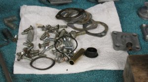

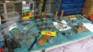

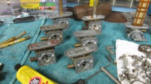

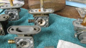

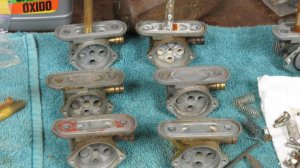

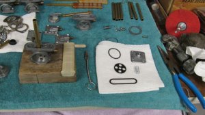

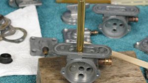

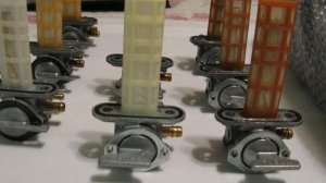

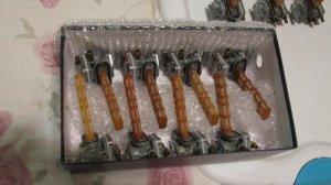

    I've been rebuilding a few petcocks lately and thought I'd post some pics of the assembly line. Some before and after pics if you look:

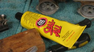

    Yeah Dave, I do use Seal-All to glue the filters back in to the bodies and I replace the plastic tubes with brass ones when I rebuild them but that doesn't guarantee they won't re-develope a slight crack/separation between the filter and body at some point. I have no first-hand experience of it happening to one that I've installed on one of mine but I did have one come back from a member that had a very slight crack in it. That's why I've recommended pulling them once a year to look closely at them to check for the figure 8 disease....even on re-built ones. I've got some in my bikes that were done three years ago with NO separation so far which is why I believe the member had an isolated case but I want everyone to be aware of my findings just the same. I've straightened some filters before that had BAD figure 8's and they did fine so I know it's not a chronic problem......we just need to watch them in the future is all.

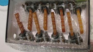

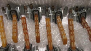

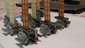

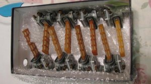

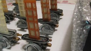

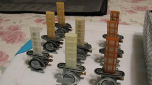

    Now that the Spring maintenance season is upon us once again, I wanted to remind everyone that 'ya need to check the petcocks while you're doing carbs, rinsing tanks out, etc. Just finished about a dozen valves a couple of weeks ago so I've got 'em ready to ship (as soon as yours' gets to me) on an exchange basis. Here are some pics of the ones I have on hand......the NOS ones are NOT for sale! For the many of you that have never seen a true ZL1000 petcock, there are some mixed in with the ZL9 ones. They leave on an exchange basis......Enjoy!
