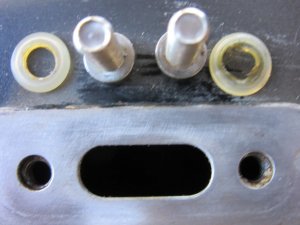

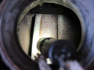

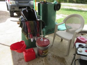

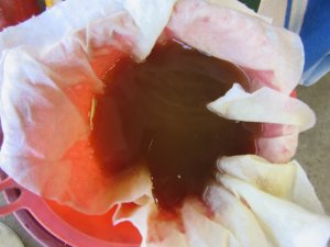

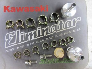

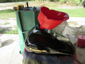

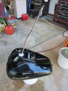

    :hello: Some time ago I bought 5 gallons of EVAPO-RUST from Summit Racing. $80 shipped. Today I cleaned out my ZL 10 fuel tank with it. It says to let the solution sit for 30 minutes. I let it in for an hour. Most of the rust came out of the tank so I let it sit over night. I'd now say 95% of the rust came out. After draining the tank I blew high pressure air in the fuel tank for 2 minutes to dry the solution. As soon as I could I filled the tank with fuel so that it wouldn't flash rust. When putting the EVAPO-RUST back in it's container I used a lawn mower filter to strain it. Then the last bit I filtered with a lint free towel. I may do it again but let it sit for 24 to 36 hours. Also I used 5/16" motion pro fuel line. Cost $2 a ft. I also use a PINGEL 5/16" inline fuel filter. One other thing I used a fuel valve that had no filter so that all the particulets would exit the fuel tank. This whole process took about 4 hours which included mounting the fuel tank on the bike. IMG_4981.JPG IMG_4982.JPG IMG_4983.JPG IMG_4988.JPG IMG_4989.JPG IMG_4990.JPG IMG_4993.JPG IMG_4995.JPG IMG_5006.JPG IMG_5007.JPG IMG_5008.JPG IMG_5009.JPG IMG_4994.JPG IMG_5005.JPG IMG_5010.JPG IMG_5011.JPG 2017-10-20-09-07-22.jpg 2017-10-20-10-02-32.jpg 2017-10-20-10-03-48.jpg 2017-10-20-10-04-17.jpg

    :hello: More pics of the inside of my ZL 10 fuel tank. 2017-10-20-10-02-23.jpg 2017-10-20-10-03-15.jpg 2017-10-20-10-03-22.jpg 2017-10-20-10-04-25.jpg 2017-10-20-10-04-45.jpg 2017-10-20-10-20-55.jpg 2017-10-20-10-20-32.jpg

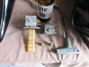

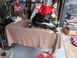

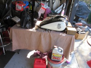

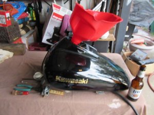

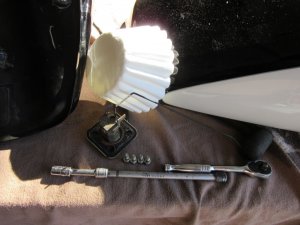

    :hello: Mike B. & I de-rusted the inside of our fuel tank's today using EVAPO-RUST. This is the second time for mine. I did mine again because the first time that I done mine I was a 1/2 gal short so about 1/10 th. of my tank still had rust in it. We let Mike's tank sit for 5 hours before draining it. It was not all that rusty. We pulled his tank to check the fuel filter which is part of the fuel pump. My fuel tank will sit over night with EVAPO-RUST. IMG_5448.JPG IMG_5449.JPG IMG_5447.JPG IMG_5491.JPG IMG_5493.JPG IMG_5492.JPG IMG_5490.JPG IMG_5452.JPG

  11. Harriminator
    Harriminator Senior Member
    881
    193
    138
    :hello:...and you de-rusted yourself w/ 'Lite'.:laughing7::occasion14:

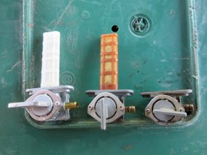

  13. R. J.
    8,596
    414

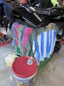

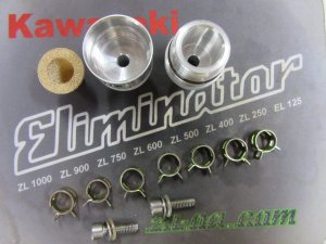

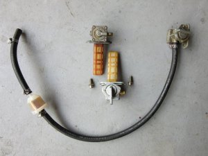

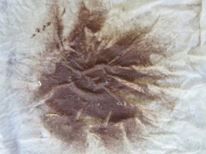

    :hello: I drained my ZL 10 fuel tank at 2 PM today. Time spent soaking was about 20 hours. In pic #1 the rust in the bucket is from 2 fuel tanks. Pic #2 has a fuel valve/petcock with no filter which is what I use to drain a fuel tank. Also I use a lawn mower filter to help keep the EVAPO-RUST clean. IMG_5500.JPG IMG_5501.JPG
